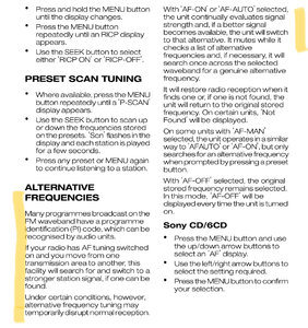

Hitta detta
Sony CD/6CD
Press the SCAN button. ‘SCAN’
flashes in the display and each
station is played for a few
seconds.
Press SCAN again to continue
listening to a station
All units except 2050
Press the MENU button
repeatedly until a SCAN display
appears.
Use the SEEK button to scan up
or down the selected waveband.
‘Scn’ or ‘SCAN’ flash in the display
and each station is played for a
few seconds.
Depending on the audio unit,
press SEEK or MENU again to
continue listening to a station.
/johnny
Hitta detta
Sony CD/6CD
seconds.
appears.
few seconds.
/johnny
Tack för ditt engagemang Johnny.
Jag har redan gjort detta och det fungerar men sedan när jag ska lyssna på en station bryter en annan in hela tiden. Även tryckt in FM-knappen så att den söker efter de starkaste sådan de stationerna som sedan lagras på programknapparna men samma störningar uppstår.
