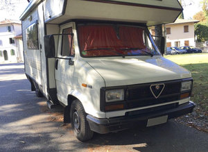

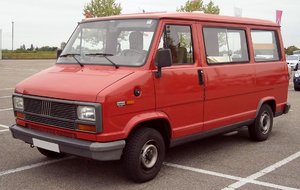

Fiat Ducato

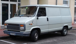

Citroën C25

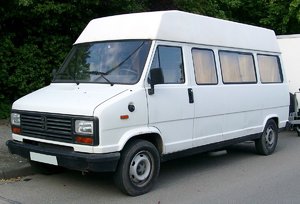

Peugeot J5

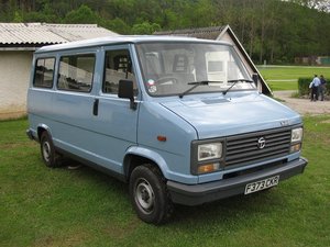

Talbot Express
Alfa Romeo AR6
