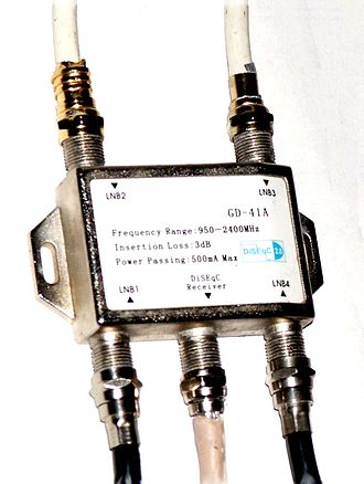

Arkilles
931
Höganäs
7551
Sv: Parabolstrul
DiSEqC (Digital Satellite Equipment Control), pronounced "Die-Sec", is a special communication protocol for use between a satellite receiver and a device such as a multi-dish switch or a small dish antenna rotor.
macab-diseqc-switch-hi-iso-2-vags-p30534
    28,6 KB · Visningar: 989
